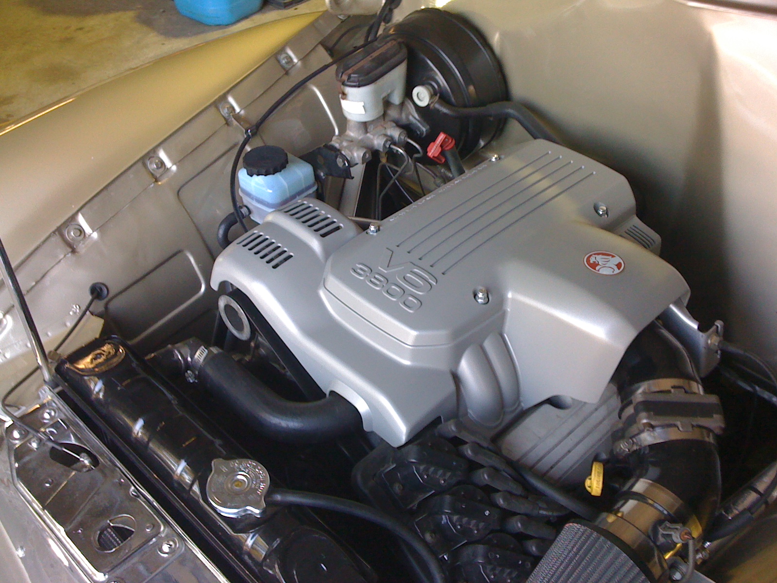

PHOTO VT V6 in situ
Morning all,

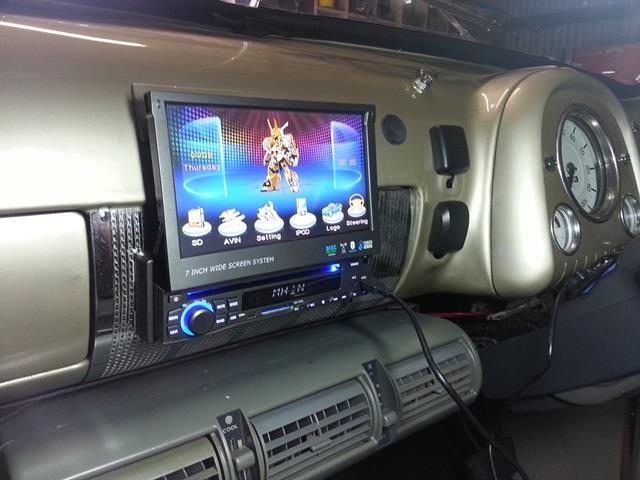

PHOTO Single din with OBDII.
In the meantime the single din player arrived from Hong Kong, and has been fitted in dash, but teething problems are preventing me from getting the readings I want to see. Why go to all this trouble I hear you thinking, well because the original speedo in the FJ is not accurate enough for driving these days when they will fine you for the slightest over-speeding. To this end a GPS based app on the iphone does the job, then I read about the above unit and purchased it. I wanted something I could use not only to check my speed, but use as a repeater of the readings related to the engine and would assist me in tuning. In addition provide a real time digital display on screen while travelling. A lot cheaper that purchasing six or seven separate gauges.
My problem is that the unit is timing out before obtaining the readings from the VT 3.8L AUT PCM, the only reading that does come up is the battery voltage, all the remaining codes don't show up. The VT PCM ( Service No 16233396) has had the key security removed and had all the codes checked using a normal reader, so I believe it produces the codes at the plug.
Might you have a suggestion or two?

PHOTO Single din with on board OBDII reader using Windows CE.

Re: VT V6 in a FJ -reading the OBDII
Very neat conversion :punk: :punk:
The issue your having is the VT PCM is not OBDII, its ALDL which is a GM proprietary protocol that was used before OBD-II. I dont know of any iphone or android apps that work for ALDL :thumbdown:
Post by Gaffa »
VL400,
ta, that conversion took me three years from a rusty paddock basher FJ wreck I found from Southern Cross.
Well what you have writen answers the question as to why I can not get the OBDII reader to reproduces the readings.
But I am still very interested in obtaining info from this PCM, I will go back to the beginners section and read thru the newbe notes as to what I have to do. I am very interested in tuning and at the moment want to gather info on teaching myself what I can do to this PCM to inprove the performance.
Would you care to make a suggestion or two.
8-)
