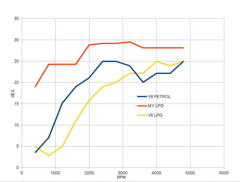

Okay. Car runs now but idles like a busted arse when cold. The Gas Research carb is a bit gummed up and previously it would only idle really well after about 10-15 minutes running even though idle mixture screw is all the way in. Cold idle was a bit average.
Overall it's a ~bit~ smoother now but lacks power slightly. Sometimes it seems to flat spot a little when moving off like it needs more advance off idle. By way of comparison, at full throttle here is my V8 LPG curve (red), V8 petrol curve I just tried (blue) and V6 LPG (yellow). Not sure if a V6 runs the same initial timing though.
It almost seems like I would get good enough results running a flat curve of 24 deg from 800 rpm up.
Three curves.png (32.04 KiB) Viewed 5049 times

try 20 deg at idle smoth curve to 37deg at 5000 max 40 above+ 10deg for light load

jenko, are those figures including the 10 deg initial timing? In other words, is the 20 deg at idle 10 deg initial and 10 deg electronic etc?
Edit -> 37deg at 5000 must be 10+27 deg.

those figures are what you would see with a timing light 20 initial and 37 at 5000 full load curve
with part load you can add a bit more timing similar to vac advance with distributor
