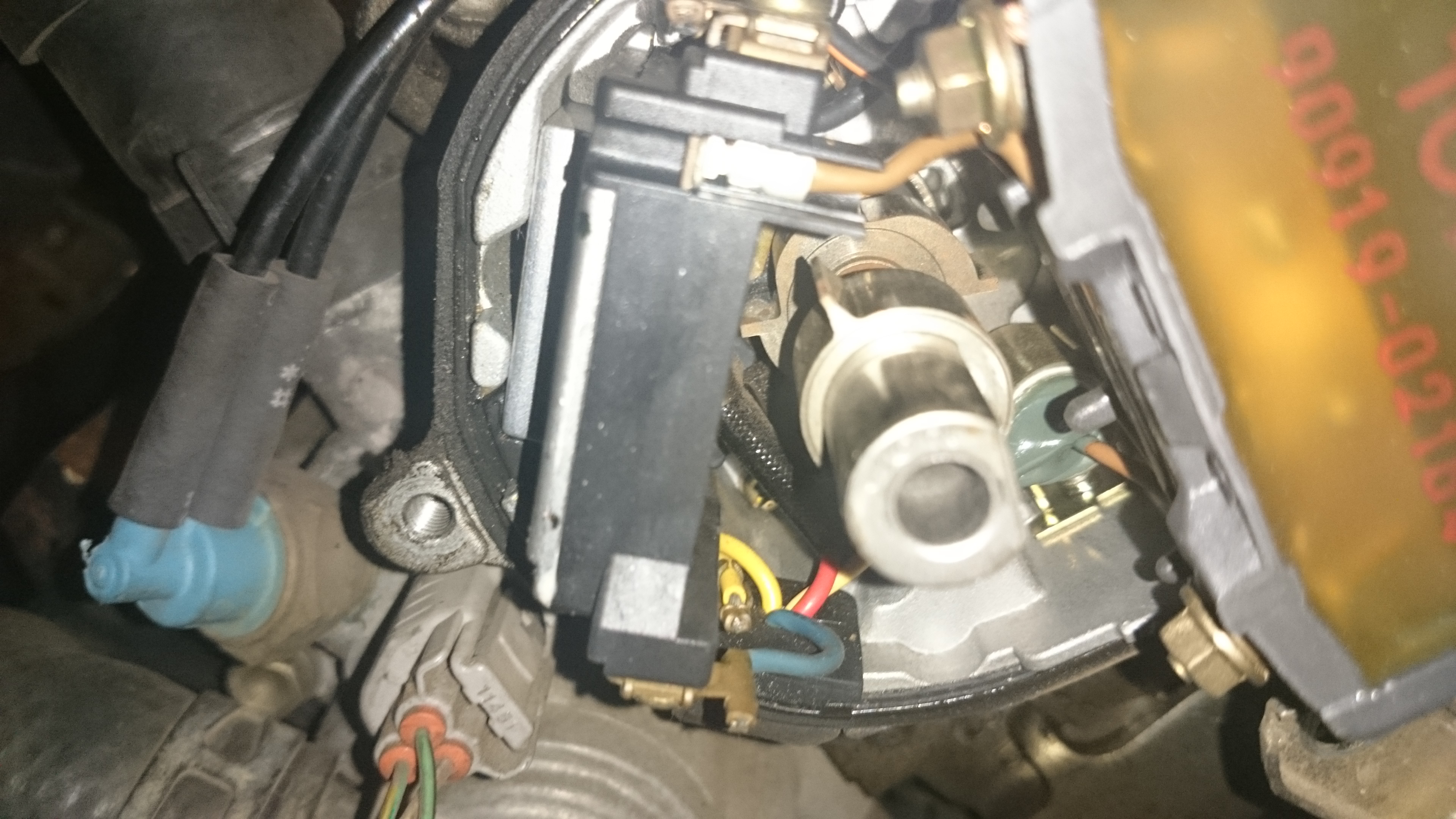

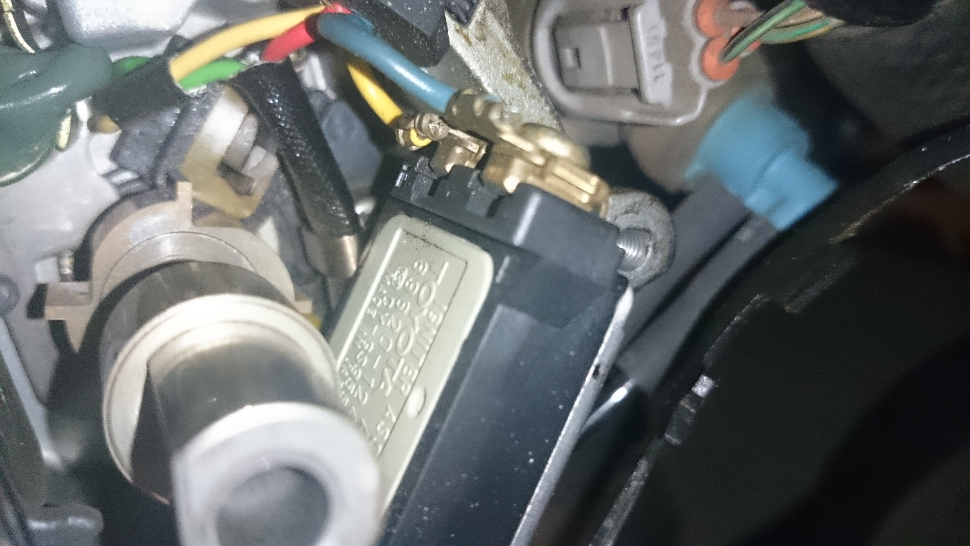

Im using a mobile phone and it wont let me upload pics of the distributor, i took the cover of the distrubutor and it looks like the coil is inbuilt into the distributor, it also has a igniter assembly unit

I just worked it out and manged to upload pics
Re: delco conversion on toyota 4efe efi engine
Typical Toyota X+1 setup. In this case the 4 tooth reluctor trigger is ideal for a camira/pulsar style ignition module.

So i would need wiring diagrams of toyota distrubutor and camira/pulsar module, and wire them together with camira/pulsar plugs for camira/pulsar harness to plug on

yes you will more than likely need a wiring diagram for at least the distributor unless it happens to have the positive and negative wires labelled etc .... theres only two from the reluctor that you need, the rest are part of the EFI loom in a camira/pulsar.
you'll also want a wiring diagram that shows where this is to be wired into the cars body wiring.
