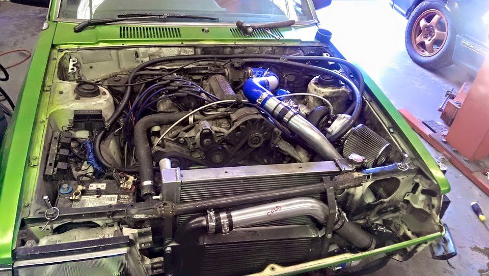

Hi everyone I stuffed up and entered a practice day (3weeks out) and havnt installed a tune i was wondering if there is a base tune that i could start with as i have a eeprom programmer and a flashable memcal
ALSO HAVE 2 BAR MAP SENSOR UNSURE IF THAT IS RIGHT FOR THESE INJECTORS i was trying to figure it out with the kinflow calculator but i couldnt change any values
stock internals
BOSCH 968 FUEL INJECTORS 440CC 42LB***
running 98oct
fuel reg undecided (recommendations?)
8psi boost
Vl fuel pump
wide band installed
car ae71 corolla (drift car)
any help is greatly appreciated :thumbup:

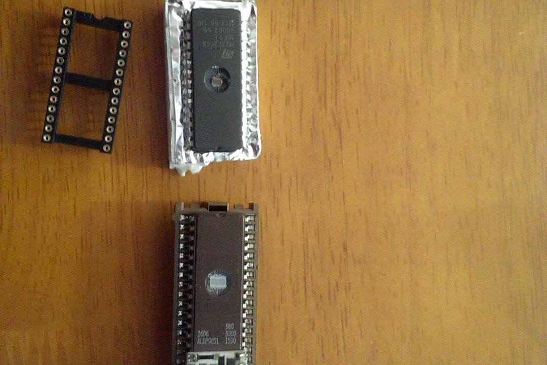

i have bought these black eprom memcal $15bucks from jaycar original unknown any help in finding out if it is from a vr ecu?

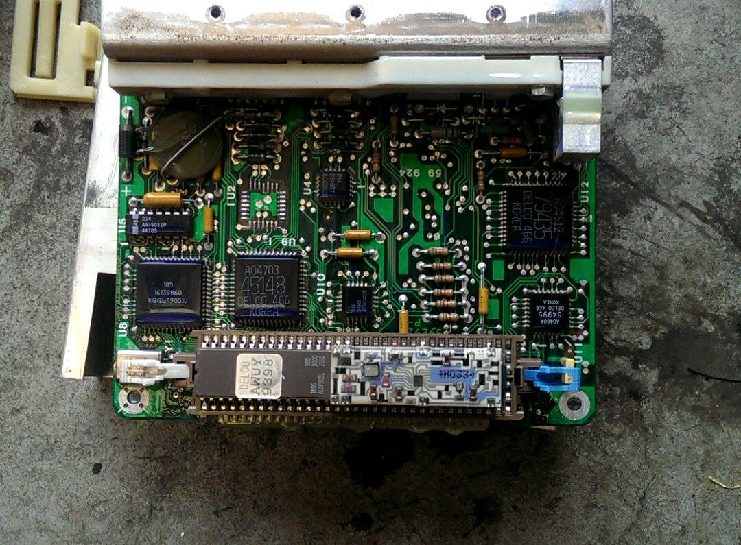

I found a photo of it still in the ecu and sticker on.
Re: the new kid on the block boosted ae71 buick
anything with a brown base is a VN/VP memcal, and these had 27C128 chips ... the 128 is the issue, this means you can't put $12P tune on it..... black base is VR and usually either 256 or 512 in size (will both work for your needs) but still all need uv eraser.
the one you posted above is a by the looks of it ST brand M27C256 .... now this will fit a $12P tune on it......
I would suggest you start by soldering that socket in your memcal then you can easily swap and change chips.
assuming the M27C256 is new and blank then you have one chance to get the right tune on it, if you fail then you need to uv erase it also.
what you really need to find is an electronically erasable one to go in place as these negate the need for a uv eraser.
I will shortly respond to your PM also.

I use Winbond W27C512 or SST 27SF512. Both work fine. The Winbond I picked up from China on Ebay.
yeah I've got a spare SST and socketed memcal I'm going to sort out for him.
