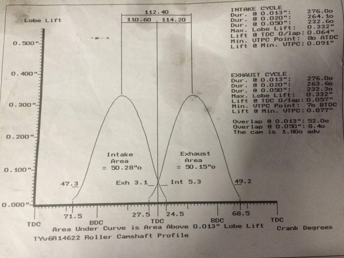

Just sounding out if any one is interested in a pretty raunchy seriesI v6 cam.

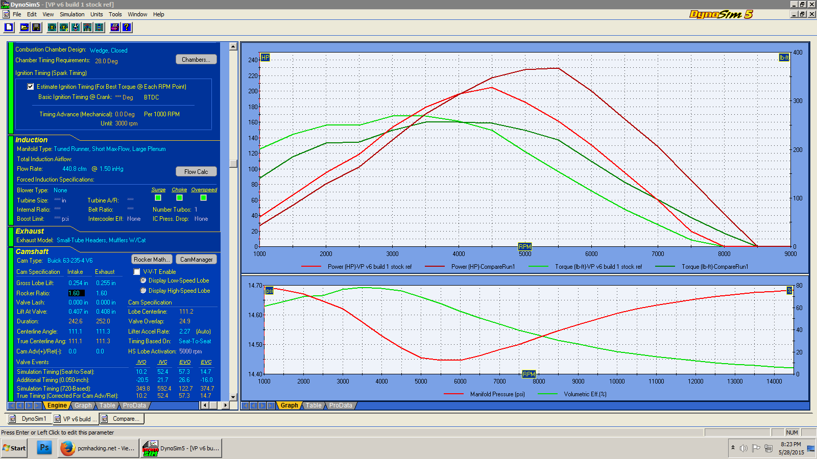

specs? i want to simulate it

Even better-

I think you might be disappointed lol.
mind if I post the results?
such a weird profile, doesn't make any sense for the v6.

Oh. Okay. Go for it.

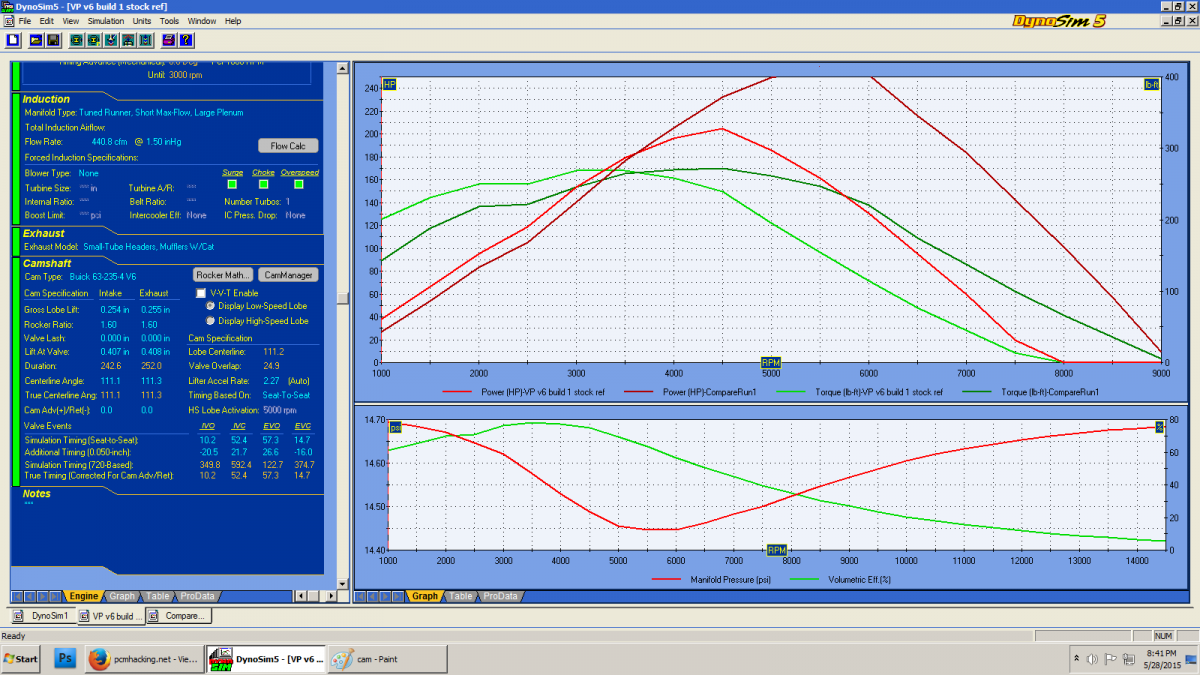

however if I retard the cam by 3º and up the comp to 10:1 and increase the lift to say 490 it reduces the loss of power from 0-3500 some what but really comes alive at 5500-6000 making over 260hp with stock heads.
you would need 1.98 rockers to even make it work worthwhile, which gets the lift to 411.
Posts: 8114
Re: EOI: series one V6 cam. N/A
as is if you bang in the cam to spec without modifying the engine.
its compared to my stock VR with exhaust and such. This is flywheel hp.
stock vr is the light colours and this cam is the darker ones.
Posts: 8114
I settled for 2º retard, 10:1 cr and 1.98 rockers assuming that the highest mace sell.

Came out of an engine running 11.1:1 comp with bigger valves, 1.65 roller rockers and ported heads. I believe it made 230 whp on 98.

mildly ported heads got it even higher at 269hp at 5500-6000
