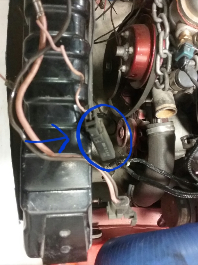

Firstly do I need this capacitor in the system?
Its between the coil positive and negative, maby its just a suppressor of some sort.

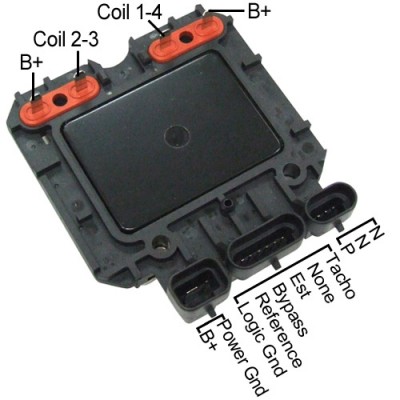

Secondly
B+
Power grnd
Logic grnd
Reference
Bypass
Est
None
Tacho are all straight foward
However
N N P I assume would be the signal from the crank sensor?
Would it be negative, shield in the middle and positive?

Yes the capacitor is a supressor. I'd recommend you keep is as the sudden current draw on any HEI coil is pretty extreme and the more you can smooth that out the better for the rest of the system.
No the signal is not the center pin (I built my first one this way assuming that would be the case only to have a no start until I checked everything!) The diagram you post is probably correct.

Which 3 pin connector do you mean? The N N P one is negative/negative/positive to the shielded wire to your crank sensor, which would normally be a 2 pin ABS sensor. Link the 2 N pins and run to the sensor. If wired backwards it'll run but really poorly so then if you suspect thats the case reverse the polarity.

Yeah the 3 pin connector i was refering to is the NNP you are talking about, thats nice and clear now.

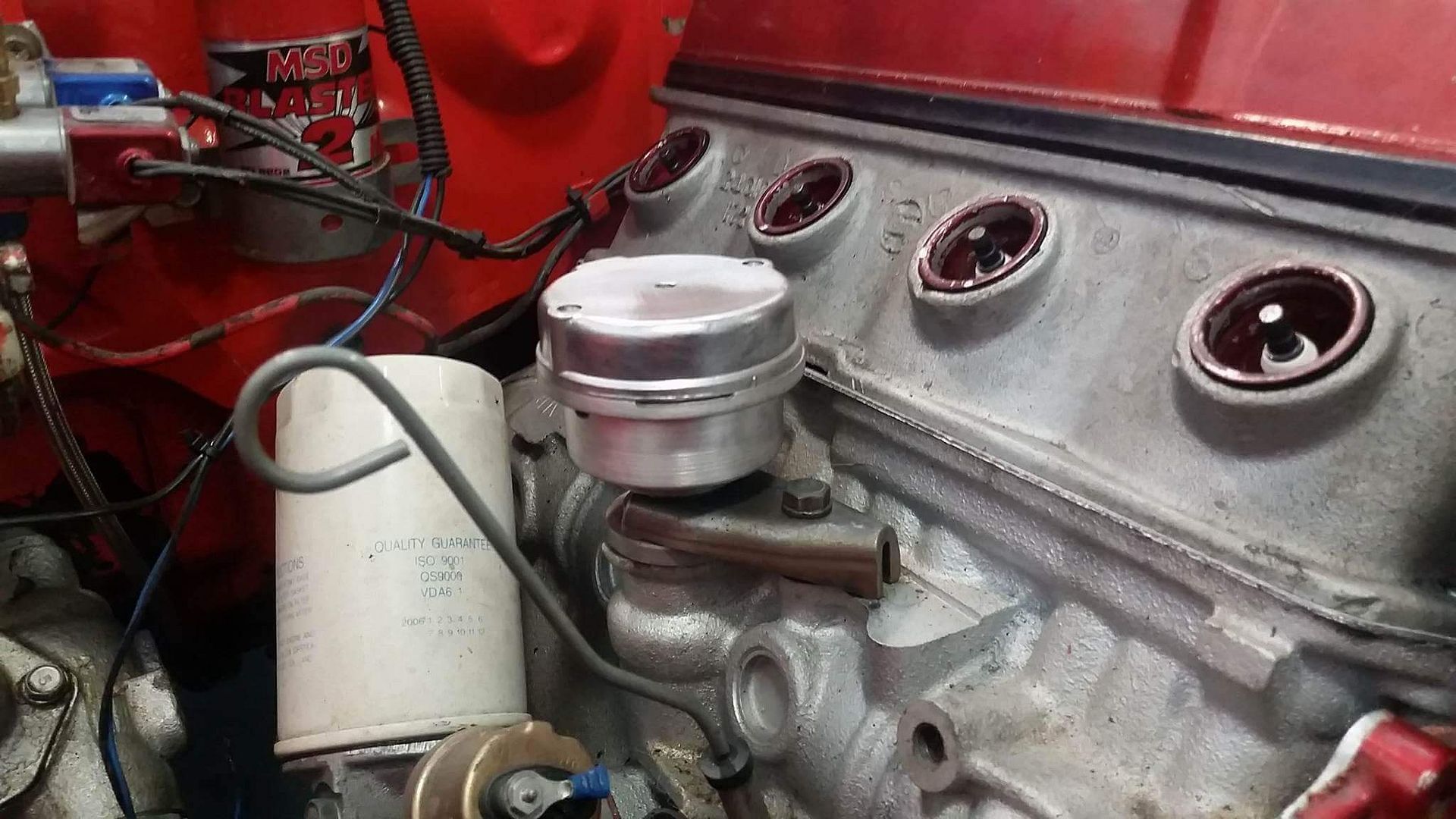

Charlescrown, I've got most of the crank trigger and dizzy done, i machined the outer case of the dizzy and found a old small dc electric motor end cap that fitted over the dizzy nicely.
The dizzy now is only there to drive the oil pump.
