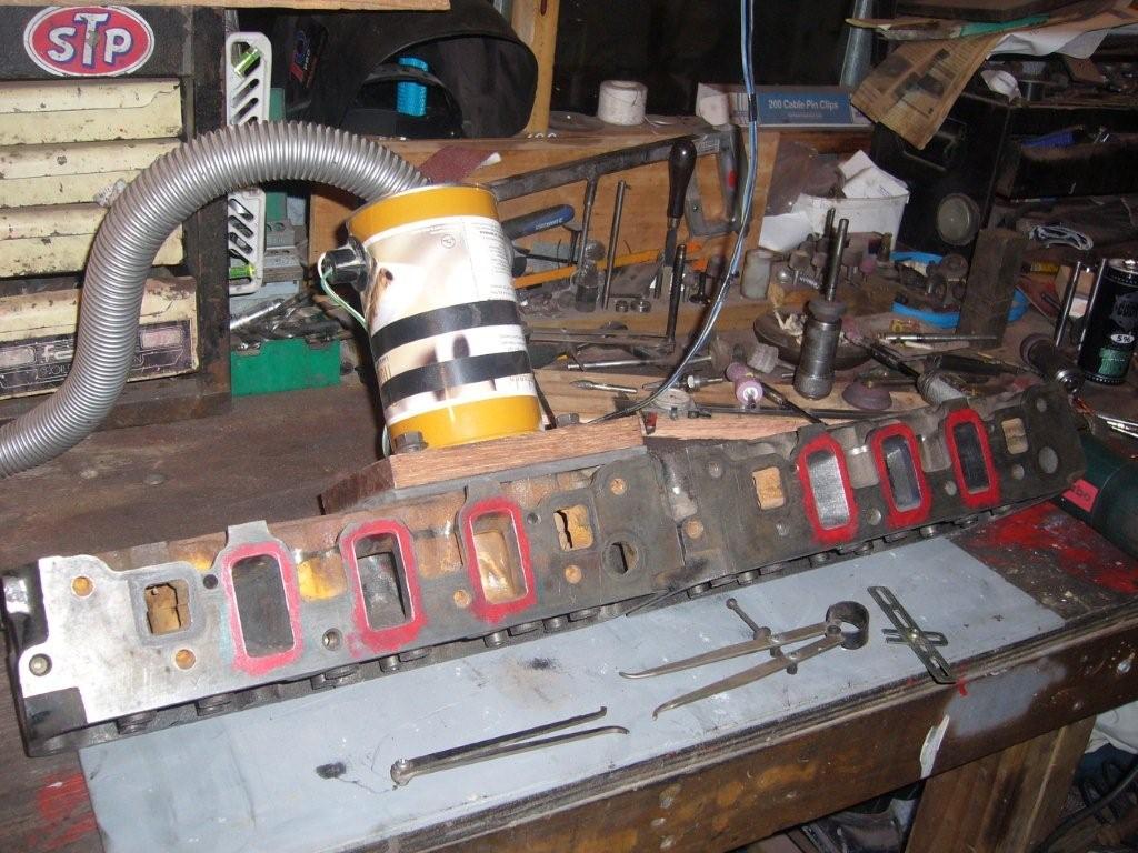

Hey Guys, havent posted in a bit, finally had a cleanup of sorts and made some space in the shed after a hectic speedway season and got motorvated to pull a couple of pairs of heads out for a tickleup.
The "rustproof" heads i pulled off a stockcar on monday for porting - lets see who spots whats fucked up here?
One inlet guide boss roughly knocked into shape seventeen to go :roll:
Should keep me out of the wifeys hair for a wee bit and then i've got a bit of a list for 34G for next season.

did you have a series 1 and series 2 head on it at once LOL the red ones :D
oh yeah i have a set of vr castings sitting here for magic treatments at some stage :driving:

Snap mate, and the 619 seriesII was on the right bank which does nothing with the extra hole in the intake face and hose was hooked up to the breather on the left side of the manifold - blanked off by the 485 seriesI casting - seemingly this is a 'trick' cos "one side of the engine runs leaner than the other" go figure - had a good look at the chambers before stripping and this thing runs fat as in 5&6 but lean up front, i think i'll be moving the carb.
whats the number under the inlet runner and on the back of the heads you have? one of those pairs has your name on it already

Righto then the stockcar pair have done a season and the owner is over the moon about them. There was a bit of a different approach to csa and throat size/shape on those puppies being two barrell carb & restrictor plate.
Next pair is coming along nicely now the season/carnage is done for me and i can get some other stuff done, i reckon if these got put on 34G it'd be an absolute dog till approaching the limiter - should work on a turbo motor tho' with some work on the intake and DECENT pipes feeding the snail.
Hmm wonder how long before we get a bite from the future owner :?: :lol:

make the valve stem area into a knife edge!

HAHA about bloody time LOL nah jk's mate those my puppies :mrgreen: light weight special series should of weighed all the port material :thumbup:

those pictures are like porn i think i just cum a little .
oh yeah i did what a mess :o

Holden202 not with the intake approach angles being stuffed up on the middle ports - maybe if i had a flash flowbench with a wetflow setup - yeah one of these days :cash:
