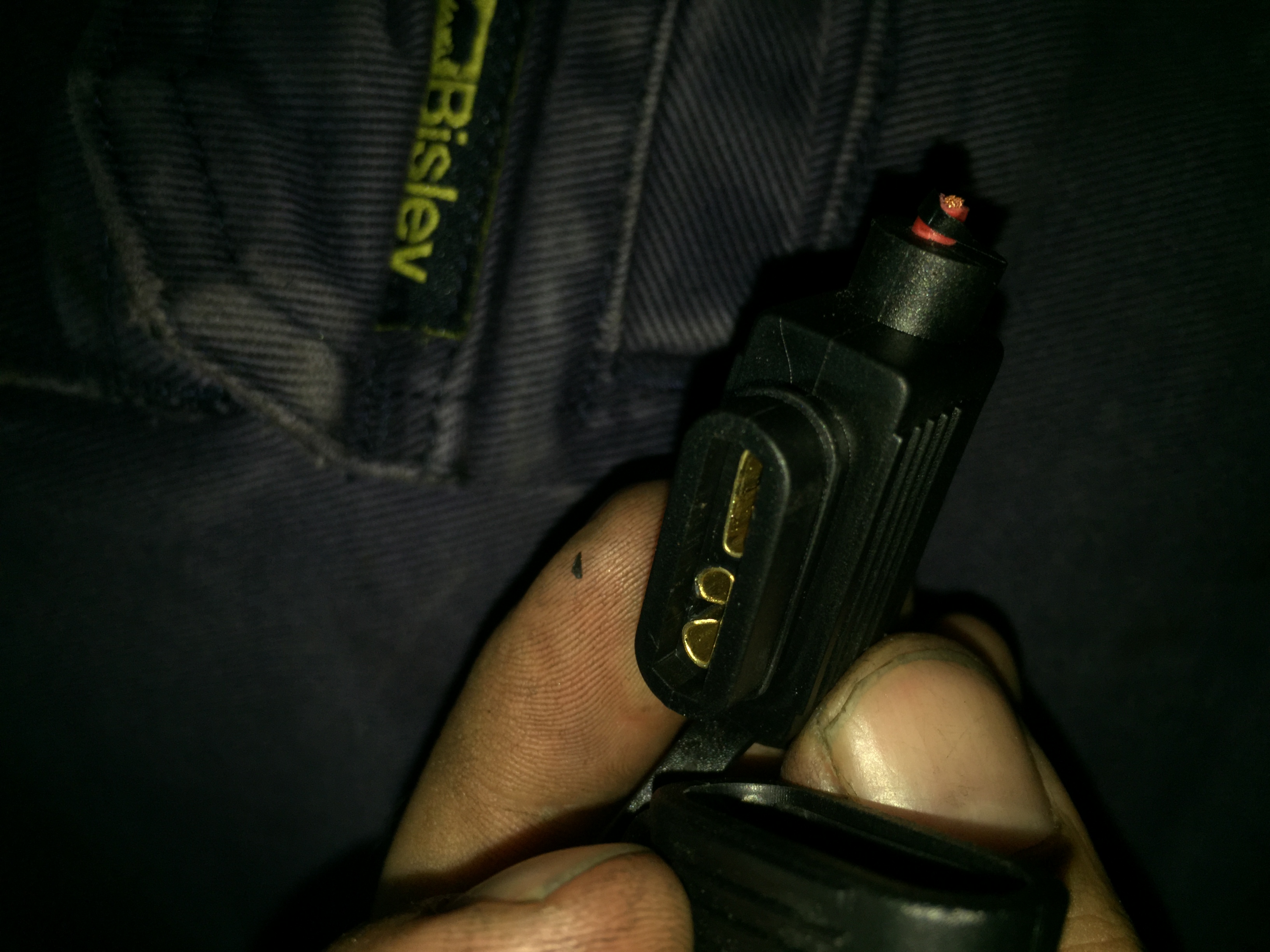

the heater ground ive ground under the dash to the chassis. I might move it from there. everything else is hooked up as per instructions. linear output to b10, electronic ground and the led ground are grounded through the pcm from memory was a11 and 12 black and red wires. and the positive with 5amp fuse was run up to the cigarette lighter. simulated narrow band I folded up and sealed off as im running 2 bungs off the dump pipe, so only needed to set the 1 narrow band up in the tunes flags

Found the issue. The fuse holder was faulty. No power at the fuse but power going in
