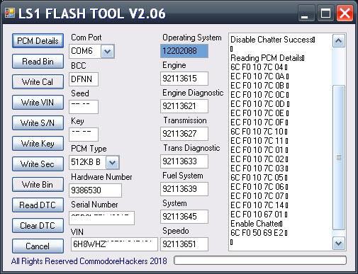

Yeah I had a look through the pcm hammer thread, though I see there's more than one option to interface into the pcm, not sure what the better option is or what lessens my chance to brick it..
I found this on gumtree, has anyone used this yet.

Yes I have that package, it has worked well for me

I finally purchased the tool I linked above and dumped the bin from the PCM tonight, and although the OS version and BCC was the same as another dump I found somewhere on the forum here back whenever, VX LS1 running the same operating system, the binary actually differs a fair amount, specifically from hex "00004000" , some at "00008000 and 00014000" & a lot from "00016E00", wondering if I'm likely to run into problems with regards to the pointers in the XDF for the 12202088 OS.
I notice the moates.net sight states the "xdf's for the 12202088 do not yet fully support the 2002 PCMs." which mine is, March 2002 Series 2.
I'll post the binary dump & file comparison dump as an attachment below.
