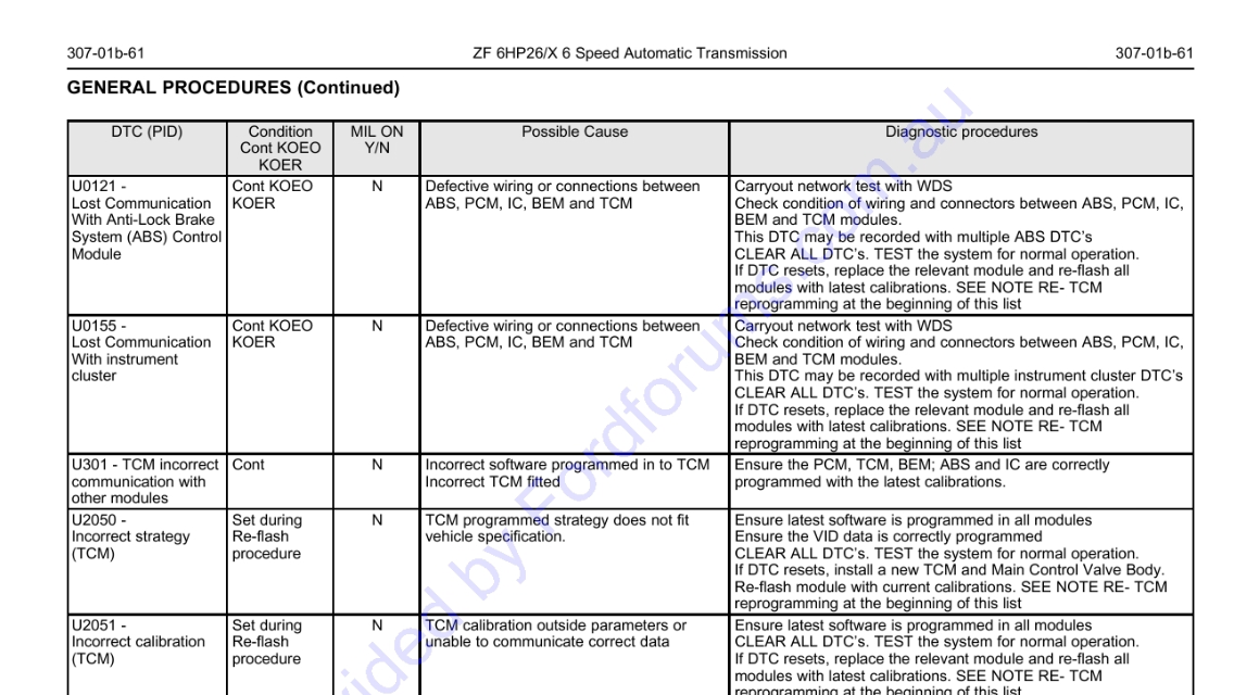

Hi all,
I just picked up a cheap 10/06 falcon sedan with zf 6sp auto & has no other fault codes in engine or abs but in the trans controller it has U0121 (lost communication with abs) & it has no speedo because of this I’m assuming & put it in limp mode!
I’m wondering if anyone else has come across this & may have an idea of what to look at?

According to a quick google it should be fairly simple, but wiring all looks normal...

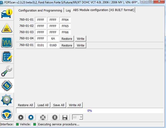

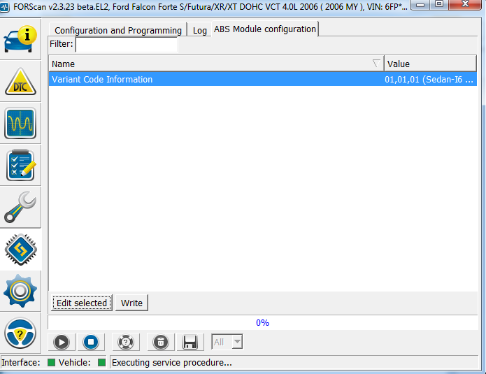

I enabled the FORScan for the free period & hopefully it will help with finding issues as I think it may be a module replaced with mismatch, but as I haven't used it before it will take a bit of playing with to figure out each section.
Posts: 2959
Re: bf mkII fault U0121
Post by VX L67 Getrag »
Has anyone got a BF MkII sedan with ZF 6speed that they can get a screenshot of the abs module info, I changed mine & didn't keep a backup of what it was before I changed it but it now say's invalid....
my bf sedan(ABS Module Config).png (54.64 KiB) Viewed 10221 times
