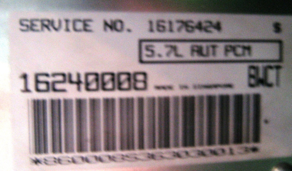

I am still waiting for some pics from my mate. In the meantime, what is the best way to read the bin out of this thing? Should I buy an ALDL reader or just put the ROM from the memcal in a chip reader? I'll need a chip burner to reprogram the thing anyway.

Pic as promised:
EDIT Holden202: cropped, and resized picture so you can see the whole label.
galapogos01

Thanks, I'd just noticed the size and was about to do it myself! :)

Post by yoda69 »
You can read the memcal either way, using ALDL cable and VL400's flashtool or with an EPROM reader.
You're right, you will end up requiring both, ALDL for logging when tuning and a EPROM burner to write when your finished.
If you want to re-write the original chip and not socket the memcal you will also need a UV Eraser.
