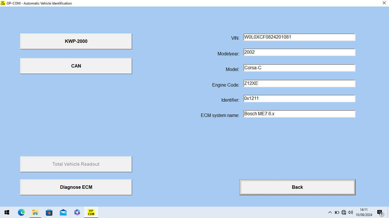

i have a screenshot of the opcom readout s attached, and the bin ripped from the ecu, also attached.
any further required info will be attached.

That's not the bin. Looks like it might just be the EEPROM. As best I can tell after a quick Google search, the bin should be 768k. What you have isn't even 2k.
