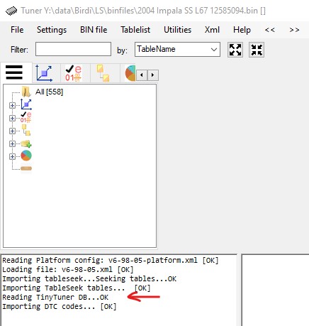

When you open V6 bin in tuner, and OS is available in tinytuner database, tables are automatically imported.Cincinnatus wrote:Hey joukoy, darkman5001 has found a way to read the v6 p04 pcms. I tried opening the bin in universal patcher to compare them, but found that those bins data isn't represented well (only a few things appear). I see tiny tuner in the folder, and thought it is used with those v6 pcms. Is there a way to see the data and tables on these bins?
Universalpatcher with Logger & Analyzer
Re: Universalpatcher with Logger & Analyzer
- tinytuner2023-03-18 085737.jpg (38.04 KiB) Viewed 13441 times
