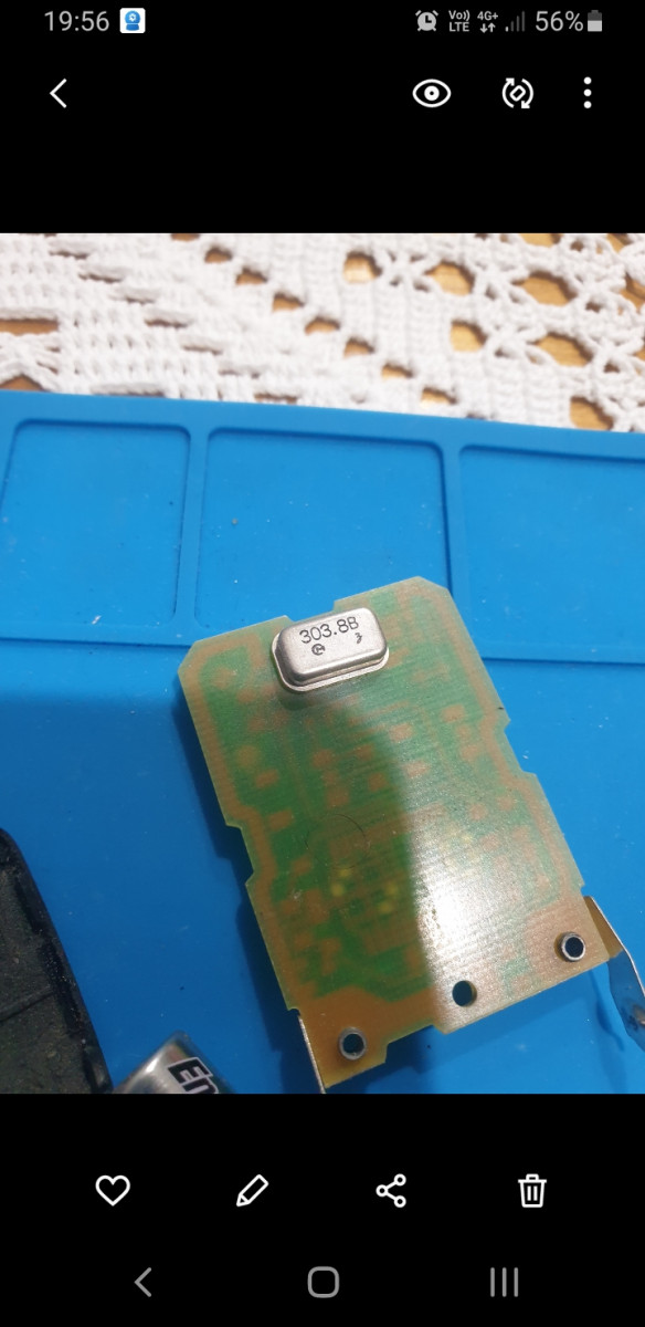

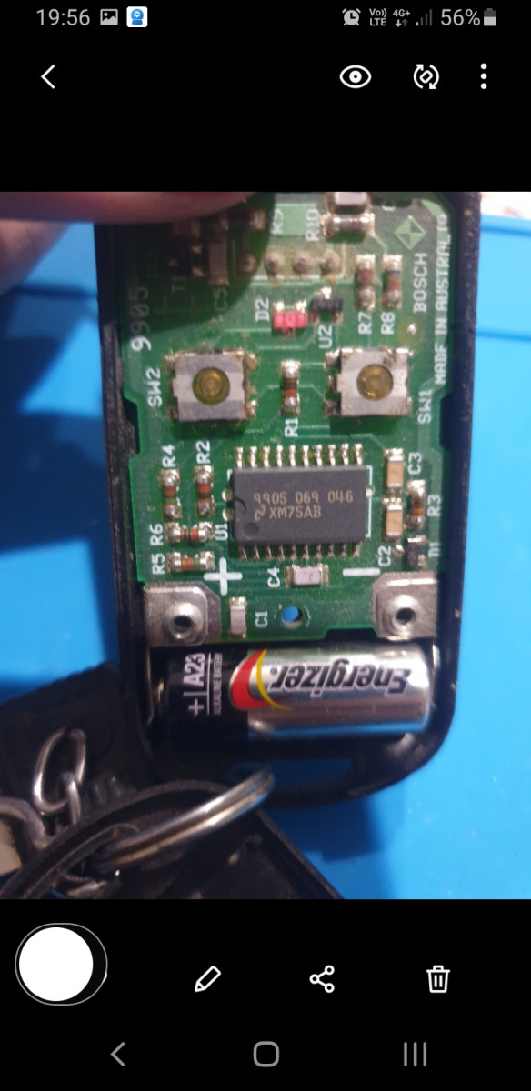

I have attached the genuine Holden 2 button remote
It has a 303.88 MHz RF crystal oscillator.
