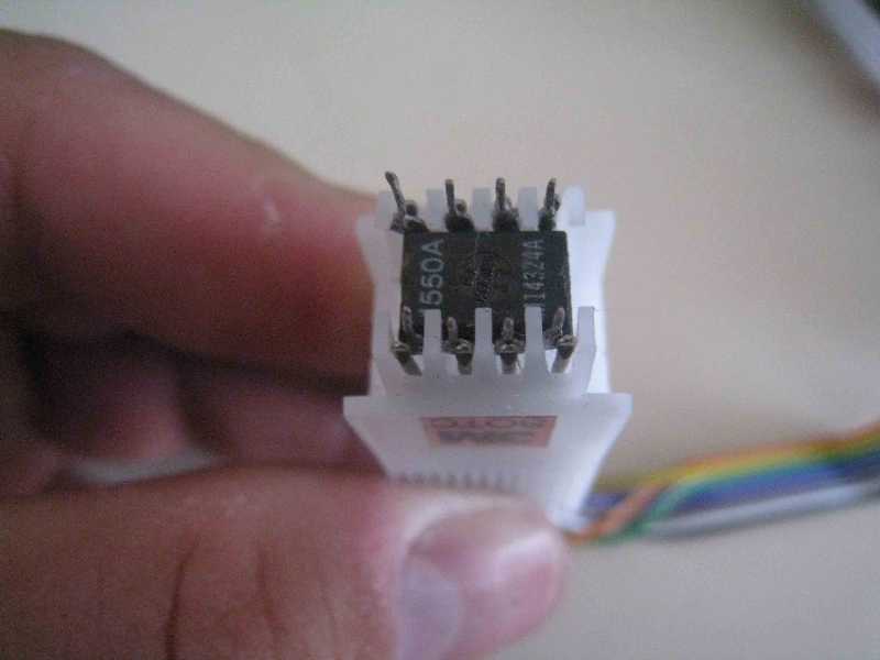

I Finally recieved my clip, wired it up and no go..... :(
So i tested clip on a desoildered chip.... Worked a treat.....
I am running a 5V 1A power supply.
Any ideas?
Thanks
Daniel

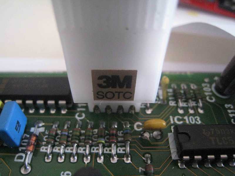

were you trying to read a chip that has been removed from the board befor. i have found that the clip will some times not get proper connection from a chip that i have replaced, i all ways put it down to my poor soldering skills,................. factory soldered chips, my clip works every time.
i had a close up of my 3M clip and it looks identical to yours.

mark wrote:were you trying to read a chip that has been removed from the board befor. i have found that the clip will some times not get proper connection from a chip that i have replaced, i all ways put it down to my poor soldering skills,................. factory soldered chips, my clip works every time.
Hi Mark,
No it is a factory soildered cluster.
Are you using an external power supply?
What brand / model reader / writer are you using?
Thanks
Daniel

level 3 trip / board - no external power supply
prgramer - Galep-4, with wall socket power supply
software - Galep 32 , downloaded from site.
