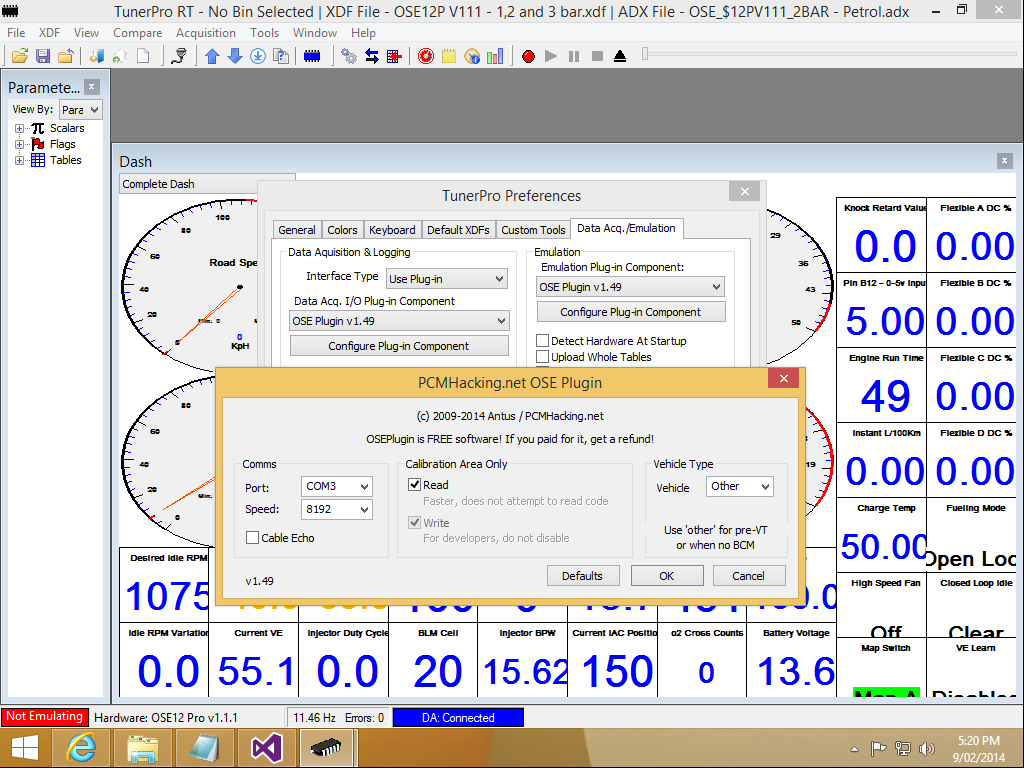

Ive had reports that oseplugin (or tunerpro) does not work on windows 8.
I have just installed a test machine to see what it would take to get windows 8 working (specifically windows 8.1, 64bit) and it turns out that everything works as it should, with just the microsoft visual C runtimes mentioned in the first post (available here): http://www.microsoft.com/en-au/download ... px?id=5555
If you have tried windows 8 with success please let us know, I assume it is also working.
If you are still having trouble, check your connections and make sure the com port has come up correctly. The drivers windows 8 will automatically install from microsoft work fine, but you may need an internet connection the first time you try.
Note that the screenshots here are logging a 12p ecu on the bench with only power connected. It is proving the communications and the pc software are working, but no sensors are connected.
