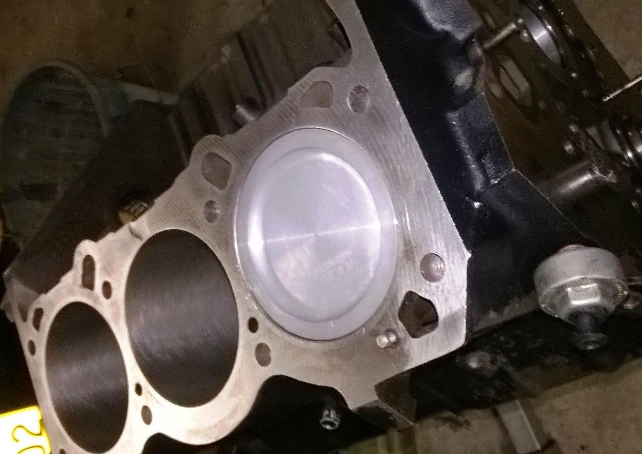

Nice looking slugs.
I've been looking for flat top pistons for an engine build that I'm doing at the moment, only found one custom setup so far, & nearly double the price of the Mahle ones.

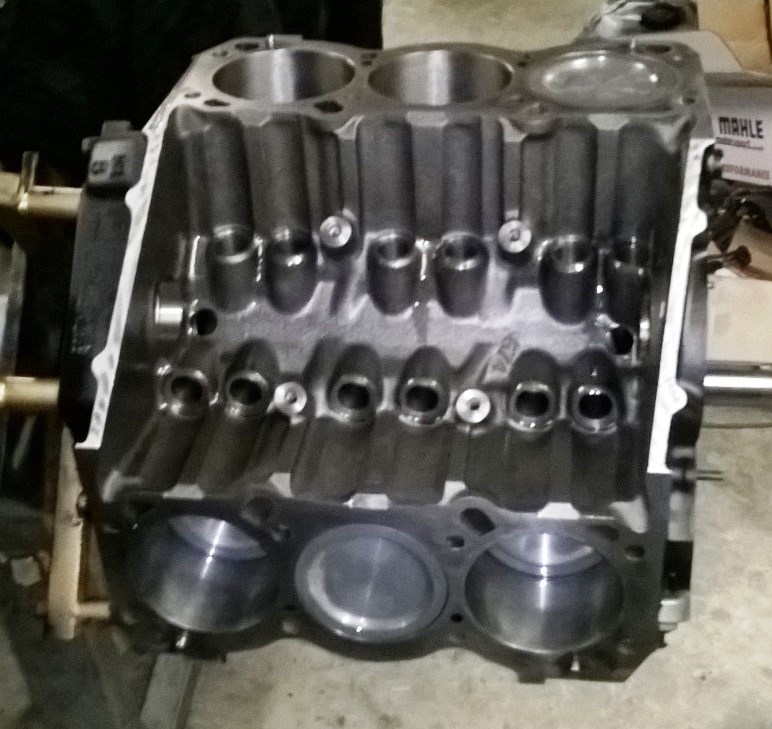

not 100% sure on the comp yet, but if the difference is what I think it will be its going to be near 10:1 ... gave the brother the option, hog out the heads or mill the pistons to get it down or look at different fuel (ie. methanol)

yeah i got close to 10:1 too as my pistons are exactly same spec just cast.
I would stick to that CR and run e85. will be no problem. will make some serious power then.

Leave the CR up, use Methanol.
Re: Mint VP V6 Sedan soon to be boosted!
yeah I guess the fuel e85 or methanol is much of a muchness, the fuel system will be the same either way and the injectors will be suitably speced to suit methanol so leaves the options open..... it sounds like the brother is keen on methanol instead of lowering the comp!
we'll just start with low boost and see how it all goes!

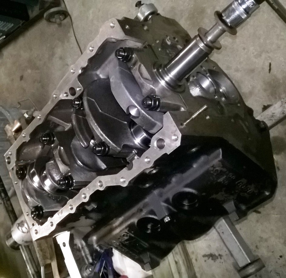

I got the block and crank back today so will hopefully be able to start assembling it shortly (time permitting

Let the forged goodness begin
next on the cards is some more work on the heads mainly to help in oil return to the sump, and then the rest can all go together!
