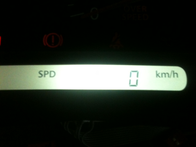

i've have the EEprom fully mapped now, tell what you want to change
to activate the digital speedo change $FB from 00 to 02

Kody's problem in particular isn't now just changing a certain feature he now needs a full write!
I'm not sure how digital speedo is even possible on vt-vx range?

COOL, never seen it enabled on the VT-VX clusters, thats 1 of the I think 24 flags that can be enabled!

That digital speedo is cool as. I have not had much time over the weekend to have any more of a play with the cluster but it seems now that 70% of the info is on there and in the right spots.
