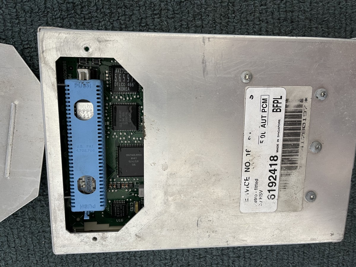

Post by Nzer »
Here it is.

Posts: 8600
Re: VL Walkinshaw Build Electronic Issues
Would suck loosing the memcal sending across the pond to me, thats the only thing that worries me.
Post by 'quipt4it »
VR 5.0 Auto = BFPL 2416 $11A
Won't work

Post by Nzer »
'quipt4it wrote:VR 5.0 Auto = BFPL 2416 $11A
Won't work
Oh so the memcal can’t be wiped and started again?
