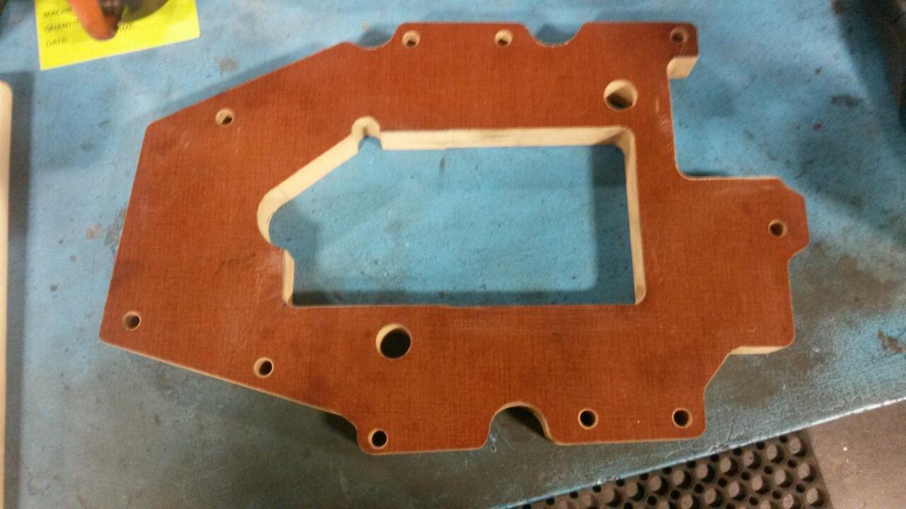

Next mod will be,
I have already machined it to match the LIM :)

I'll be interested in your findings on the spacer.
Posts: 10436
I assume that's just to help with stopping the heat soak ?

Yes that's the purpose of it.
Posts: 8600
Where is the intercooler core?

im with vlad on this, defiantly needs a core in that spacer,

$1100 for a whole water to air setup isnt that bad really, could probably do it cheaper, with there plate, a fish tank pump and a motorbike radiator, or a small car one

LOL, yes a whole W2A setup would be nice but it's not in the plans ATM however the LIM has been machined to suit should it ever eventuate. I'd probably not buy a whole kit, rather just the core and then make my own setup to suit as I think they can be improved upon.
Holden202T wrote:I assume that's just to help with stopping the heat soak ?
Yep.
Although what we have discovered on my mates car is that the blower still gets fairly damn hot. My conclusion is that the little gearbox on the front of the blower creates plenty of heat itself. With my current setup on a cold day after cruising down the motorway the whole intake tract stays fairly cool until the back of the charger where elbow bolts on and it then progressively gets warmer till the snout which is getting fairly damn hot.
