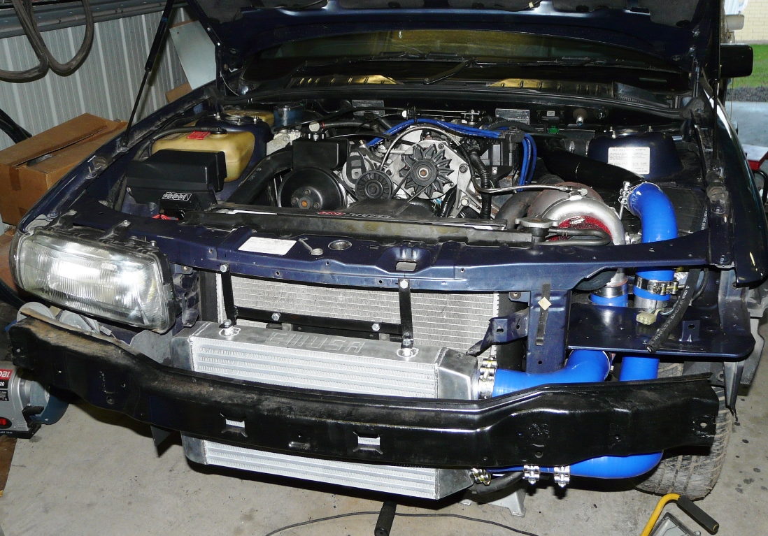

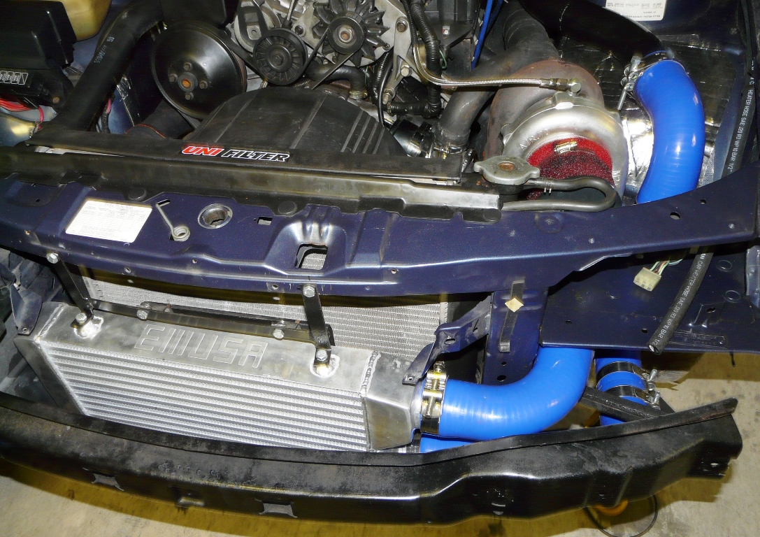

well finally got over sicknesses and other hold ups and got the intercooler all plumbed in for the VP!
had to cut half of the bumper support bar away to fit the pipes in but I suitably re-inforced it with some square tube beside the part that was left :)
all that's left to do really is to make some brackets to support some of the pipework and put it all back together and shes ready to go!
the brother is hoping everything pans out and we might see some dyno time this Saturday, but that's just a thought at this stage dependant on everyone being available etc.

all coming together nicely :thumbup: Got a HP figure hoping for?
Re: Mint VP V6 Sedan soon to be boosted!
yeah we want to do 340hp at the treads :) I don't think its possible but that would make a certain mate with a N/A 304 quite cranky and we like stirring him cause he's a "fuck the 6 just put a v8 in it" man :)
honestly I think anything 250hp ish would be great for what it is.
