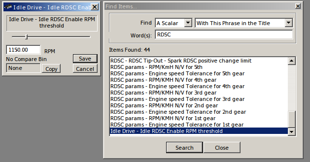

Re: Disabling 12P Tip-In Bump spark and auto tranny.
Nuh, no flags, only scalars. Could this be it?
- RDSC scalar.png (38.29 KiB) Viewed 5645 times
i'd say you need to change one of the temp enable scalars for it!
like increase this to max temperature....
RDSC - Minimum Coolant Temp To Enable RDSC
