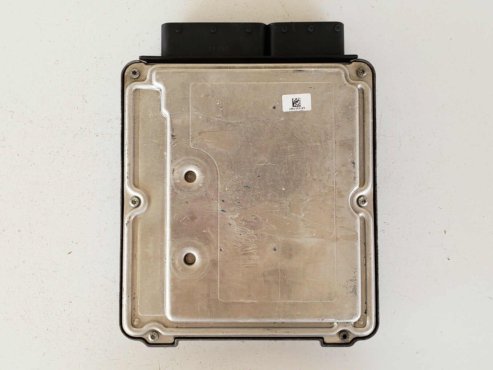

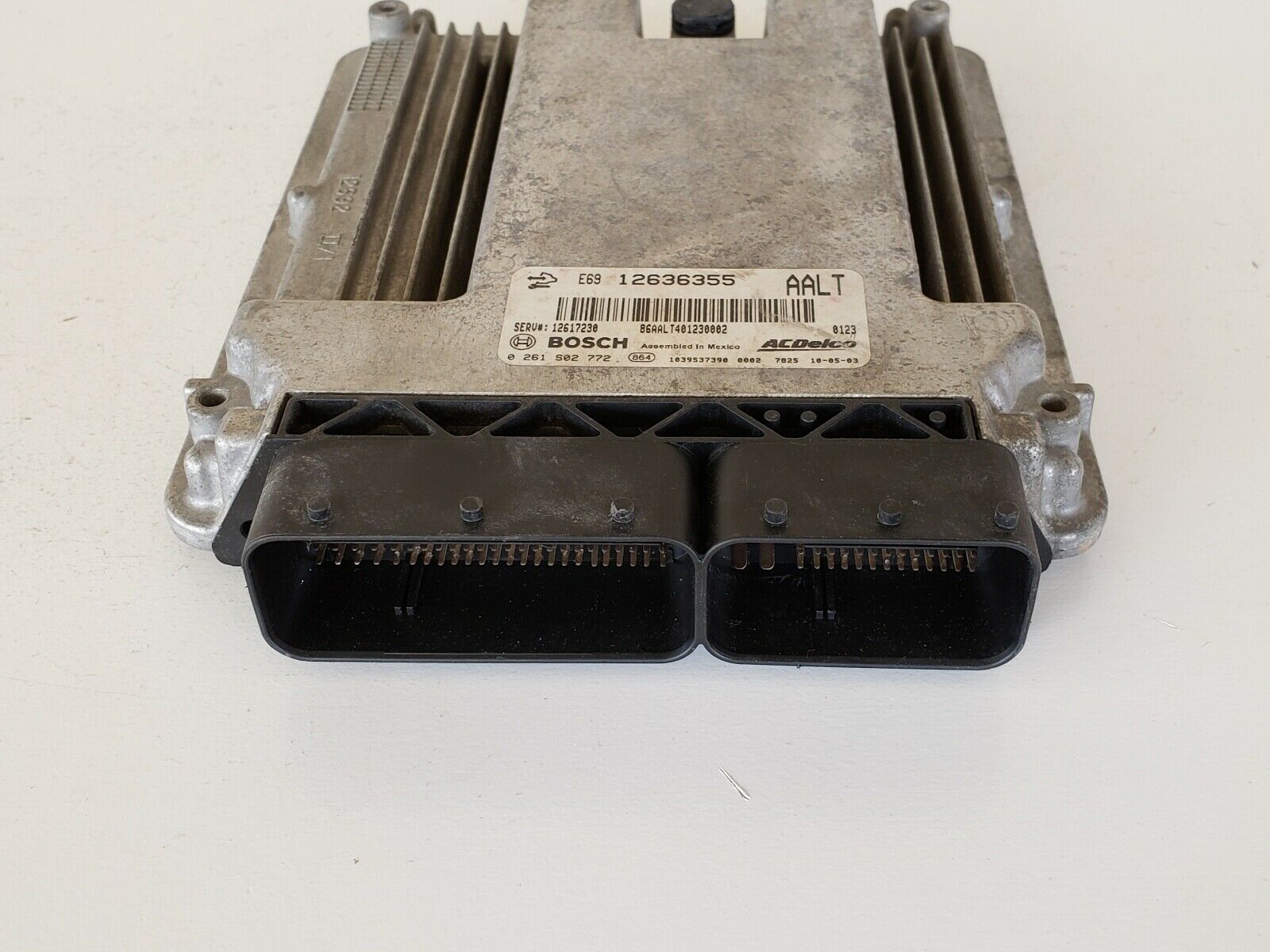

I am wondering what is the bosch equivalent of this pcm used on 00-11 sidi v6 vehicles.
A bin from the e69 pcm or the bosch equivalent will be great for some research project. And some pics of the internal components.

It has the exact same chip and memory as the E38. I can grab a bin from it latest this weekend.

Its a med9.6 ecu. Its similar to the ones used in opals and saabs.
