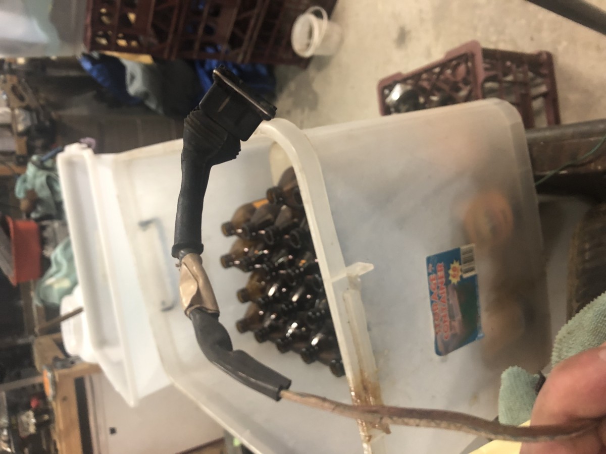

This is the plug

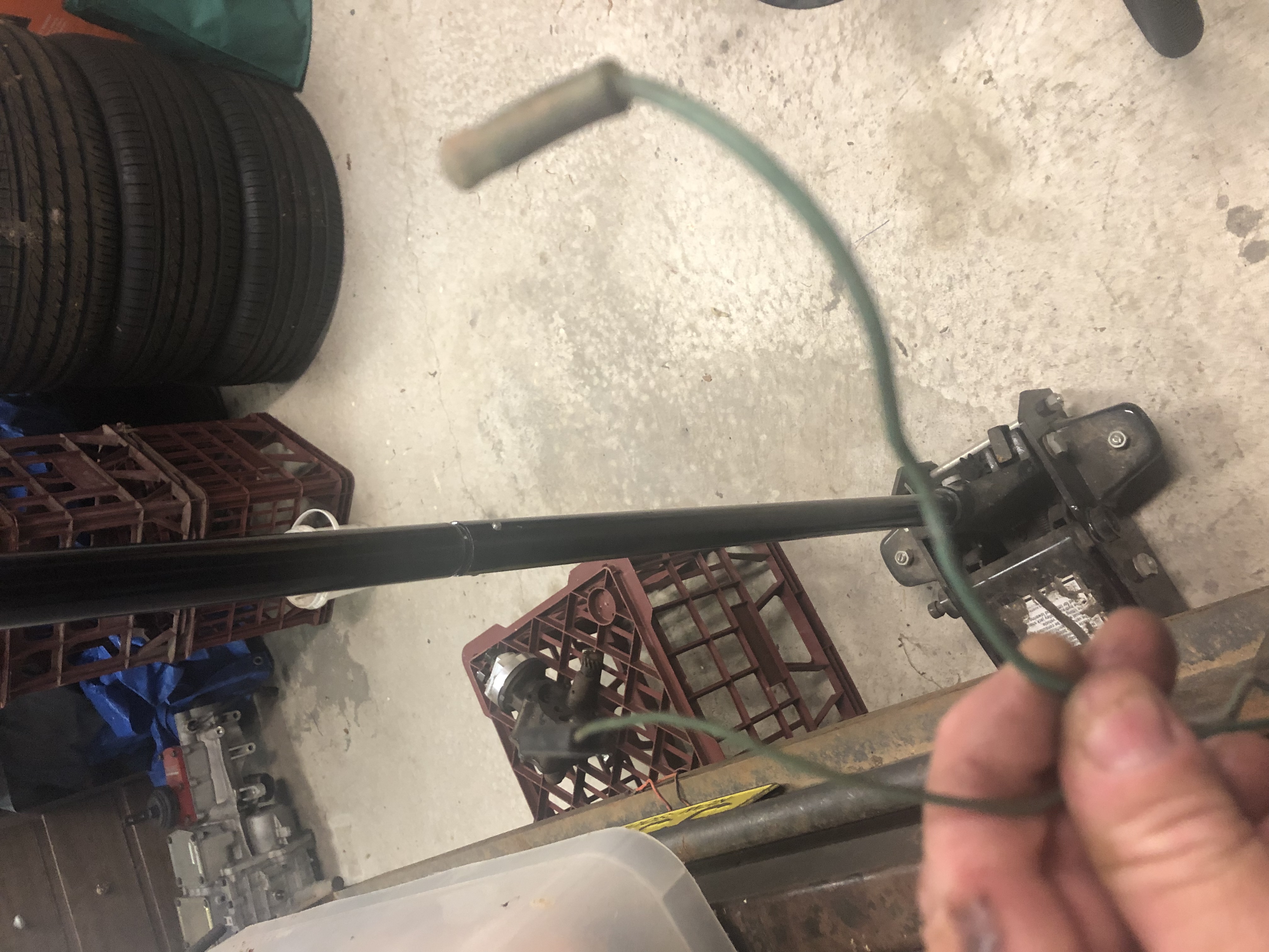

And the other two single green wires.
Posts: 2605
Re: Guessing plugs on loom
Assuming it’s a V8 loom, the injector type connector should be ignition coil, the green wire with the female barrel connector is the A/C compressor, the green wire with the female blade is temp sender.

It’s a V6 loom.

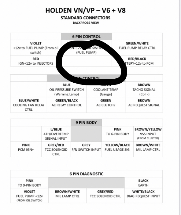

With injector looking plug the white wire is going here to the 6 pin control plug.

And the brown wire is going here to the 8 pin control plug.

After stripping more back I found a extra Tacho signal wire which was hidden in the tape.

Where did you get those documents from?
I'd love to get a hold of them
GH1176
Posts: 116
Joined: Thu Apr 17, 2014 9:25 pm
cars: 1974 Holden Torana LH SL
Post by GH1176 »
Dylan wrote:Where did you get those documents from?
All off this forum mate.
