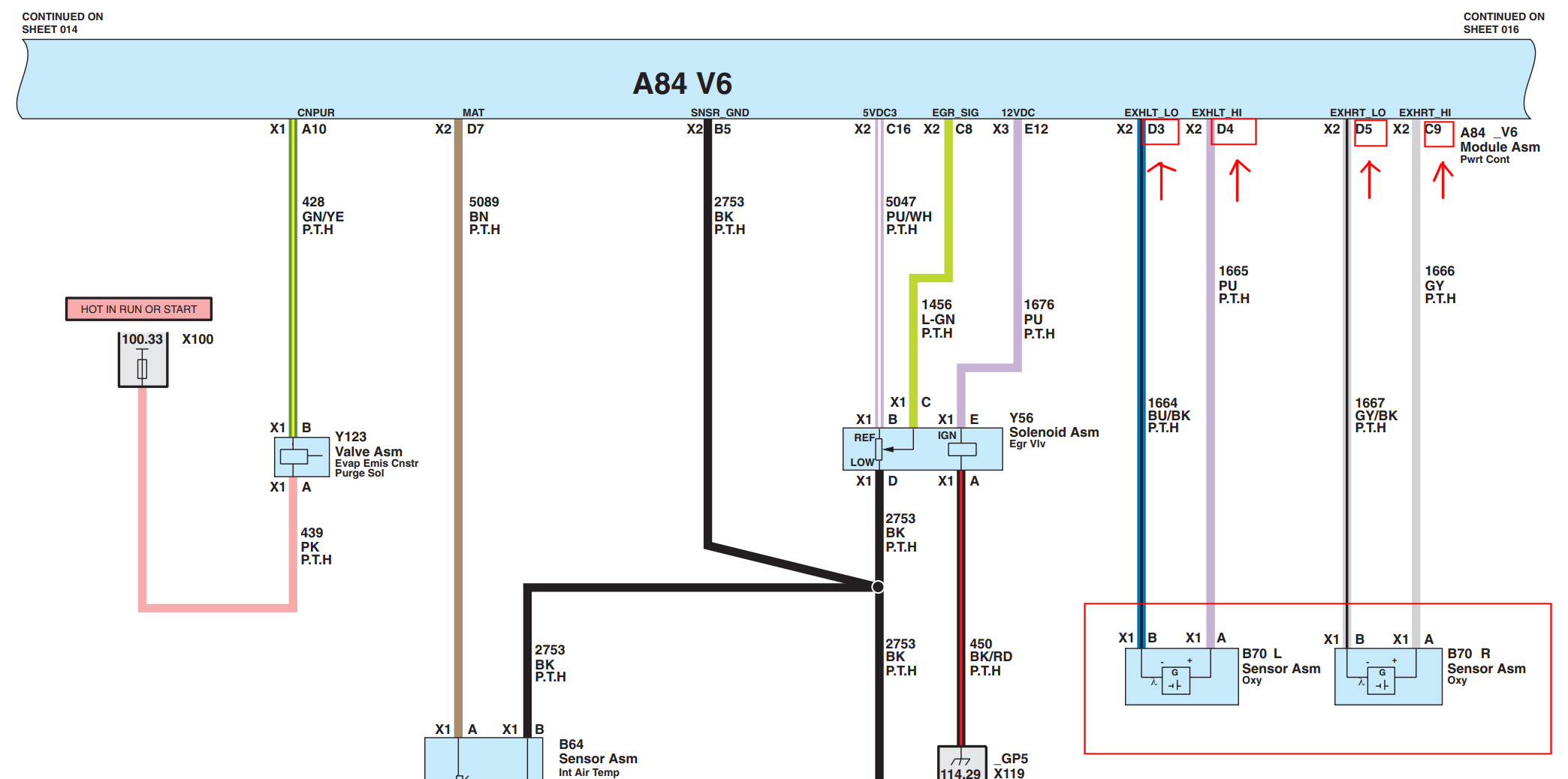

Brand newbie to group. Looks like u guys will all over my following question. I have a Ford Transit ice cream van with a v6 conversion in place. Motor starts and runs fine. Trying to connect o2 sensors in engine loom but the guy who fitted the engine forgot to leave o2 sensors plug exposed and now is tucked in behind engine and firewall. absolutely no room for access. I am looking to run new wires from the sensors to pcm.
Can anyone supply me with a diagram of pin positions for the v6 pcm. Numbers on v6 pcm are DSZT service no. 09356445 or wire colors and volts from pin. Connectors on the pcm are blue and grey.
Also I am looking for info of the o2 sensor wires before the plug. mine are 2 wire, colors of wires are violet and light brown. just need to know signal and earth as I am sure they will be different colors than the engine harness wires. I have searched this forum extensively but could find an answer.

https://pcmhacking.net/memcals.html searching 09356445 shows its VX/VY/VY PCM so look at the wiring diagrams here: viewtopic.php?t=134 and for some pics to help here: viewtopic.php?p=70686#p70686

here

thanks mate i looked at that one but didn't see the oxy wires. mine are different colors though to those pins. can i find voltage somewhere for the pins to be sure. do u know what color wire out from the sensors would correspond to the pins my 2 wires are violet and light brown. eg does violet go to pin d3 etc. i really appreciate your help
